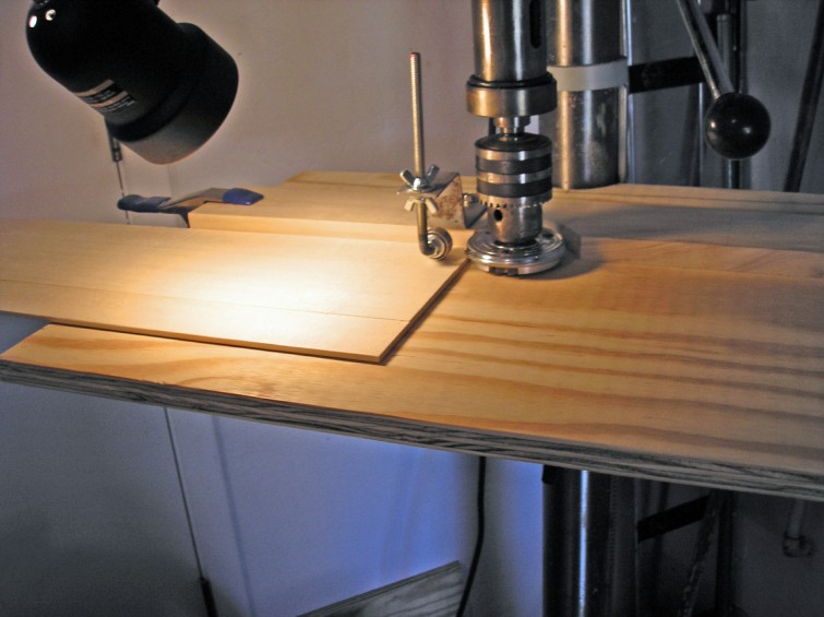

I thickness everything with my Safe T Planer, tops, B&S, headplates, rossette materials etc. etc. Take small bites and hold on tight and move slow, I have not had any problems.
PostPosted: Sat Jun 02, 2007 8:18 am
[QUOTE=Ricardo] Just don't try to thickness small pieces like headstock veneer. The SP will grab it and gouge it. I have more fear of this thing than just about any other tool in my shop. The difficult thing with this tool is being able to hold it down well while moving your work under it - easier to do with larger pieces.
You should really only use this tool on a drill press where the quill can be locked down in the position you want it, so that both hands can be used to manipulate the wood. I would think it dangerous in the extreme to hold the planer at the thickness you want it with one hand on the press handle while moving the wood with the other. If your press can't be locked down at the thickness you want it for the planer then don't use a safe-T planer at all if you want to keep all of your fingers.

Agreed with Colin, if your Drill Press does not have a position lock, don't use the safe t planer or by a drill press that does.
My set up is like Dave's above and I go mostly with the grain like you see in the photo above, however on headplates and rossette materials I could be going in a variety of grain directions. If you don't get in a hurry and you are set up right, this tool is very easy and clean on the cuts.

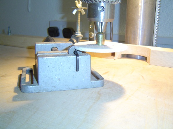

I sharpen the cutters as suggested in the SM guide, with the cutter held in a drill vice. Take care not just to follow the flat of the cutter or you'll end up just cutting the edged section off!

I used a rigid scraper to flatten the bottoms of the pockets. The part was a good quality investment casting, and was 'flat' by many standards, but not flat enough for this application. It only took a few minutes to remove the small amount of material needed to get it truly flat.
I lapped both sides of the cutters. I actually used a grind wheel in my Dremel to remove material from the center of the cutter, so that only the edges needed to be lapped. Again, with that done it did not take long to lap the surfaces on a diamond stone so that they'd seat properly. You must check to be sure that all three cutters end up the same thickness, or one will be doing all the work, and the tool will still grab.
I just hand sharpen. I wish I could get another one of those wheels without having to buy the whole outfit! The second one I bought did not come with the wheel, and mine is getting pretty small after 30 years of use!
